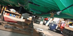

Had a bit of an adventure with a torsion bar last night.
You see my TB tool there just past the end of the speedo cable, and the torsion bar to the rear.

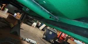

Also note what side of the torsion bar crossmember the tool is on.
This car came with a bunch of crap welded to the floor as part of the roll cage, that I saw no reason to cut out. Of course a piece of it is right in the way.
I wailed on it to get it out. Don't know how it's going to work going back in. If I can get it in the hex I'll just wail on it again.
Worst comes to worst I'll break out the sawzall and worry about making it pretty again later.
It's only on the driver's side, because race car.
FWIW the cheapish Amazon.com torsion bar tool worked great, and I got my valvetrain disassembly tray so I can remove the rockers and all that to get at the bottom end.
