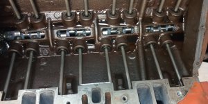

Engine stuff ...

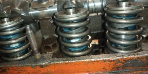

Actual dual valve springs

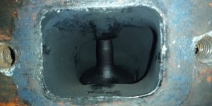

Looks oily. Hopefully just stupid rich.

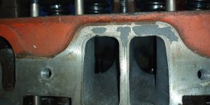

It definitely looks rich on this side too. Heads have at least a homebrew porting job from the looks of it. Can see grinding where they thinned around the valve stem area and the port looks like it's been smoothed. If they're usable, these may be worth reworking?

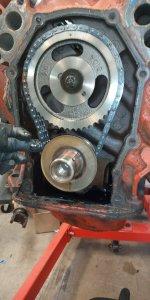

Double roller, some wear. The slinger is on because it's stuck.
Supposed to be a 509 purple shaft. Definitely hydraulic, definitely purple.

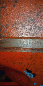

72 440, not HP

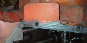

Anybody you know? Jefferson Road was a C-body plant.
I thought I took photos of the top of the head but didn't - 346 heads, iron adjustable rockers.
