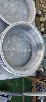

Well trim rings would not cooperate, I could not get another on any wheel, now the first on that's on I did by hand, but it never seemed to lock in.
The rest would just keep popping back & forth, so to check that I'm not going completely nuts I pulled out an old one, right on with the rubber mallet, all the way in & tight!
Came the closest on the left rear, but if I try & get that last part flat it just pops the whole thing out, so I go back to the one that was on, tapped on the part that was out a little & the whole thing popped off!
First bump & these would be rolling down the highway! 20240316_161249.jpgSo I put em on the bench to compare, new are deeper & have much bigger locking tabs, gonna go search them again & see what the other options are? 20240316_161003.jpg20240316_161042.jpgThis shit is starting to get to me!

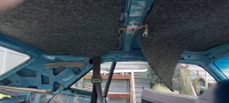

So today I decided to do things that won't go haywire & piss me off, that didn't last long, opened the door & found some of my roof insulation hanging!!!!!!!!!20240317_124245.jpgBetter not happen again, my can of spray glue is about empty.

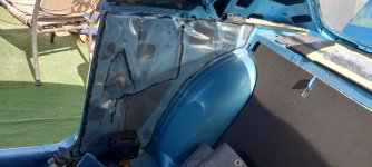

So I glue that up again & move on to more mellow stuff, replaced my 3-piece vapor barrier with one piece, thanks again 68! 20240317_140223.jpgSo I move on to that stuck bleeder on the caliper, put a deep socket on it & got it free, i did already have some damage from the wrench slipping, was rusty in there, so I cleaned off the rust & put a dab on never seize on it.

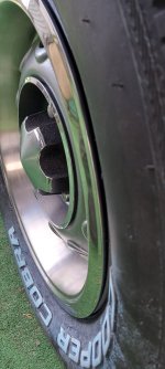

While the wheel was off I noticed rubs on the rim where they shouldn't be, those trim rings with that extra lip were bottoming out! 20240317_140249.jpgnext was the passenger seat if that didn't go smooth, well I don't want to think about it.

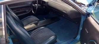

20240317_142004.jpgthe carpet still has some little bulges but mucho better than before.

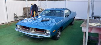

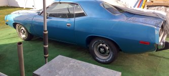

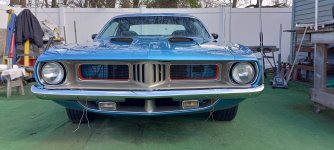

So I final glazed & waxed the hood & top of the fenders, 5 feet away I have a show car! 20240317_150843.jpg

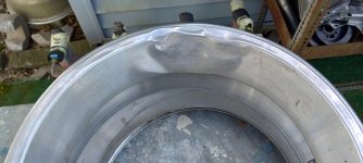

Picture this baby coming at you at 140+20240317_150947.jpgso I pull my old rings back out, pretty bruised up, 3 I might live with but this is a goner! 20240317_152209.jpgrest are about this bad? 20240317_152217.jpgSo against my better judgement I start sanding on some of the touchups

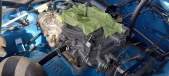

Last but not least how do I stop this, carb is already getting puck marks from sitting out there????? 20240317_155146.jpg
