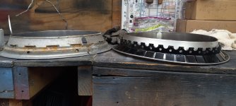

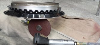

So I set up the grinder & was about to start when I looked at that nice slot I had to get down to, hmmmm maybe a cut off wheel will get me there a little faster.
Well it wasn't exactly fast but probably cut the time in half. 20240321_143238.jpgSo I took that one out & tried it on, went all the way in, a little less of a pry to get it off as compared to the 6" rim but pretty tight. 20240321_150549.jpg20240321_150605.jpgIt also gave me a nice line from the machine work to grind to.20240321_151001.jpg
same height as the old. 20240321_151651.jpgStarted on the second one, when I started grinding I noticed it wasn't a flimsy as the other if I left a little of that inner lip on, so I took that out & tried it, she cleared & seems a little tighter, so I'll leave the lip on the last 2, then wait & see what the first pothole does to them???

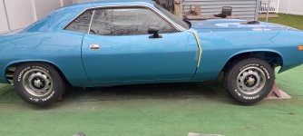

So today I finished the cuts on the rings & set up my belt sander & smoothed em out a tad more.
I still have my doubts about these babies staying on, guess time will tell.
So we have some flash flood warnings for tomorrow, not sure how high the water gets back there, at the house it's 14" deep, the marks on the garage are around 11, & at the back of the door on the car the seem is at 11" so rather than take a chance I jacked it up yet again. Will leave it up for a while so I can spin the motor by hand if I have to for the distributer install.

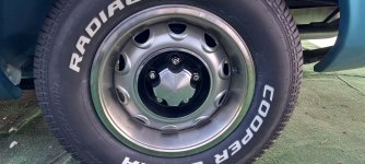

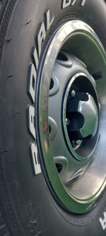

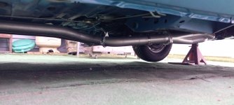

Well for now we have rally's.20240322_161605.jpgAlso that low hanging exhaust has me worried, it's only 4 or 5 inches off the ground in the middle, gonna see if I can twist those front angle pipes behind the headers & get it up some???20240322_161740.jpg

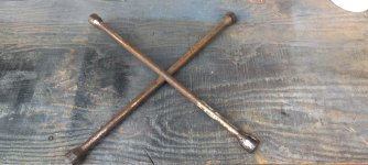

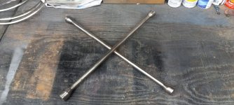

So looking at my 4 way I'm like geeze I can't put it in the car like this. 20240318_163550.jpgSo while the grinder was out I started the cleanup process, should look a tad better in black! 20240322_162446.jpg

Messed with the exhaust a bit, not sure till I drop her back down if I did any good, loosened all the clamps that go from the header flange pipe to the X pipe, hoping that angle pipe between them would twist up a bit, jacked it up & down a few times, figured I did as much as possible when it started lifting the car.
how it looked before20240324_145617.jpgThe way I think it should look, I did go out back & check the tips, they stayed good.
20240324_145141.jpgI checked the offset on the X pipe it's about 1 1/2, so if I tried to flip that it would go up 3", doesn't look like enough room to do that?
See what I have when I drop it back down?
