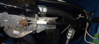

When I lined up the 2 cables the new looked like it may work, slightly more cable cover on it? 20251123_142007.jpgGet it all layed out & same problem, at full open for heat the cable cover is just outside the clip.

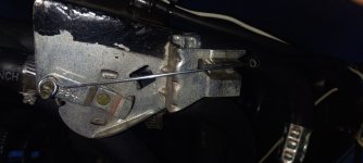

20251123_145940.jpgOne of the comments on the post I found said you could rebend the wire shorter so I gave it a try, cable cover fully in the clip.
20251123_150425.jpgsuckycess, not a perfect bend but it works!

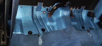

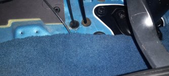

Seat back out, my old seat foams not doing so good......................20251124_140039.jpgGave that area a good clean up & while the vac was out I hit the front too. 20251124_141258.jpg20251124_140544.jpg

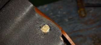

On to the retractor, pretty nasty in there, I had to pop the plastic off the rivits to get the cover off.......20251124_142117.jpgAt that point it did unlock & roll up, so I poured oil on all the outside spinning stuff & a bunch down the middle where the spring is, seems to be running smooth now.
I was just about to glue it back on when I noticed the holes in the plastic were smaller than the rivets, took a small screwdriver I managed to work it back under the rivets, one is perfect, the other a little beat up but even with out those it was on there pretty tight. 20251124_142938.jpg20251124_142928.jpg
