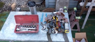

On to the gas tank, set out some basic tools...............& coffee of course! 20230321_133003.jpg

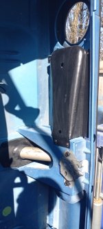

Set in the sending unit & the lock ring looks a little off, it is set into 2 slots pretty sure the sender is right, Also may need to pound it around further I think those stops go under the bulge in the ring on the tank?20230321_133936.jpg

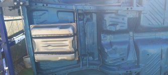

I seem to remember some kind of foam under the gas tank straps, so I put some "gummy" tape on under them. 20230321_140541.jpg
So after installing the fill tube & gasket section wrong 2 different times I finally got it right but scratched up a lot of my nice new paint! 20230321_155128.jpg
Also finally got the trunk lock rod fixed & the cover on that, scratches on my tube & the bracket it goes through, uggh! 20230321_155054.jpg
After seeing this gap in the strap I tightened down quite a bit more, still a tiny gap, gotta find out if it should be flush? 20230321_155152.jpg
