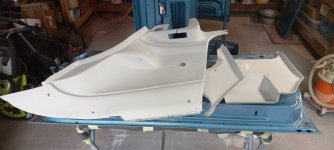

At this point in time I don't even remember priming the plastic I painted. Seems like I just used the plastic prep and then painted it. But it's been 15 or so years ago.
Plastic prep is for bare plastic, before any primers or fillers are used...You're going to apply a plastic prep before any paint, right?
If not I've got a can of stuff I used a long time ago and can look at the label (seems like it was an SEM product), and there's Restoman too, who would definitely know what works best.
I do remember it was strictly a color change in my case and I didn't need to do any sanding.Plastic prep is for bare plastic, before any primers or fillers are used...

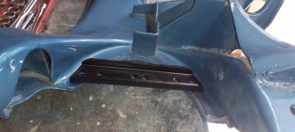

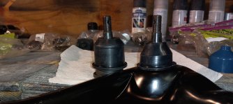

About the same height but all rubber, the old had a metal set peg I suppose I could drill a new set hole

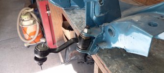

"Idler arm" I would try to install the new. First see if the rubber bushings will compress, either by c-clamp or vice. If it will, do what's needed to install. The new one appears to be of better quality.Last & worst is the arm that connects the steering rods to the K frame, mucho different, old slides between the ears easily, new won't go in maybe a 1/16 off?

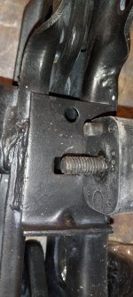

I wouldn't drill a hole to make the part fit. The hole and the 90* bend in the mounting plate hold the bump stop in place and you will have a hassle tightening it up without the part fitting those correctly.Any thoughts on the LCA bump stops?

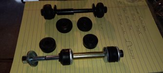

Not sure I put them on the bolt right but the new is way longer than the old?
