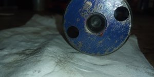

Noticed this on the crank, looks like it was stamped?

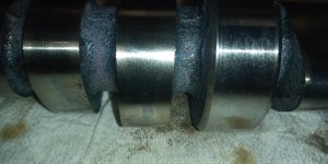

The other side - nothing you can catch your fingernail in

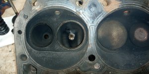

This is where the valves stopped in the 915 heads
As close as I could get to seeing what's under the valves

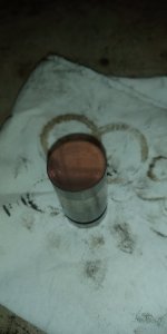

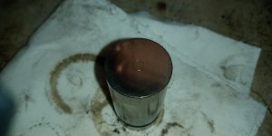

No crosshatch left

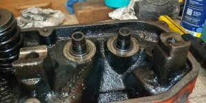

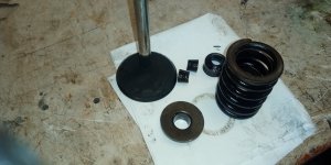

One head is apart. All guides passed the "pop!" test. The compressor rules once I figured out to try to center the valve stem in it even though it's damned hard to see it so it's a do by feel sort of thing ....
Yes, these heads have been worked a little bit
The others were the same, intake and exhaust. It all seems high quality.

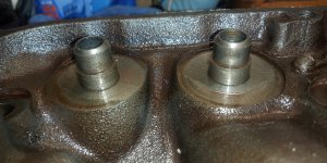

Guides cut for positive seals

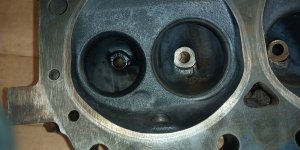

I took some photos of the chamber in the 915 vs the 346. I don't think there was any real "porting" going on (yet) but they definitely did the 3-angle plunge cut yada yada that all machine shop worked heads used to get. That explains what looks like porting in the chamber, it's part of the plunge cut.
915:
346:
915:
346:
Valve sizes are the same, everything else is different because race car. The 915 parts look stock. They had umbrella seals on intake and exhaust.

I noticed that the spring seat on the 346s is kind of eat up from the machining and suspect that is why they all had spacers there. You can see it in the photo above on the left side of one, the bottom side of the other.

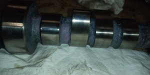

The cam's supposed to be a purple shaft .509. I haven't stuck a mic on it yet, but I'm confident that's what it is. Google didn't match the number to anything (yet), apparently it's before a change in part numbers.
Showing its age too
None of that will catch your fingernail but it ain't nothing. Time for a new cam?
