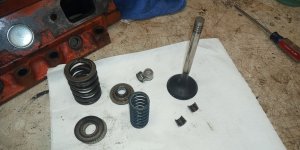

One head is apart. All guides passed the "pop!" test. The compressor rules once I figured out to try to center the valve stem in it even though it's damned hard to see it so it's a do by feel sort of thing ....
Yes, these heads have been worked a little bit
The others were the same, intake and exhaust. It all seems high quality.

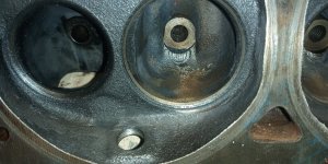

Guides cut for positive seals
Somebody did a little grinding in the intake port, but not a lot.
You can see it a little better from this end.
