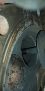

This is where the valves stopped in the 915 heads
As close as I could get to seeing what's under the valves

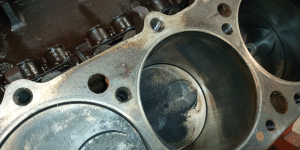

No crosshatch left
