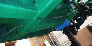

From recent experience with frame connectors - don't cover up the holes in the TB xmember that brake lines, fuel lines, and the e-brake pass through.
I ended up finding a way to get the brake lines from inside the frame rails out the outer rocker like it should be, but I ended up having to run the fuel line down the inside of the frame connector, and cut a hole where the connector meets the frame to pass it through there.
When I got the car it had AN fuel hose from front to back so the passthrough wasn't strictly needed because you can just run that stuff anyway you need to because it's flexible. 3/8" fuel line, not so much.
Thanks to all that, I've got part of a brake line and a complete 3/8-5/16 fuel and return line kit that I can't use.
This is how the brake line was run to begin with and is now:
You can see the hole it's supposed to come through at top but there's no way to get the line from there to the other side. You can also see the e-brake pass-through and for some reason they removed the inside of it. Right now I found a 1/2" washer fits just fine since I can get it in through the back side and it can't go anwhere so I don't think it really even needs welded to hold it in place.
The fuel line just runs inside the rail from front to back, so it's not protected so much from flying broken parts.
All I'm saying is, don't paint yourself into a corner if you don't have to (y)
I'm planning on keeping the original fuel line's path through the TB crossmember. I'll also add another hole for the return line right next to it. I'll weld some pipe pieces in the crossmember to create pass-through channels for the fuel lines. I don't want anything passing under the frame rails and crossmembers. Since that means custom routing for all the lines, that's why I'm using raw tubing kits to roll my own.
Running the hard lines inside the frame rails sounds interesting, but I'm not sure I want to go through that much trouble. Running them along the inboard edge of the frame should give adequate protection for the lines IMHO. Anything that can reach that far to damage them up there will also give me a lot more to worry about.
I still want to move the exhaust routing to outboard of the frame rails as side pipes. Rerouting the exhaust will help keep the heat away from the fuel lines, brake lines and wiring.
