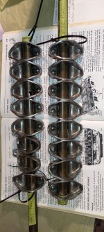

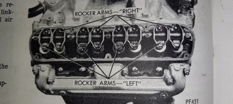

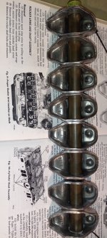

stumbled upon rocker instructions so I laid out the rockers.
one side the notch goes to the front, other the rear, so I did the one in the pic first.............
Before all this I didn't even know there were left & right rockers, now my only question left is do the left & rights for the other side start at the same point, it didn't say in the book, maybe the push rods will give me a hint?
for now I ran them the same.

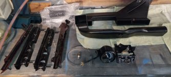

& got the small speaker grilles painted up.
