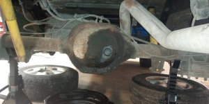

The rear end, not so much.
Paper thin and coated with grease
I put the wheels back on but forgot to measure. I figured they'd all be the same, but no, you can get 9" or 10" brakes. Those look like 10", right? Yeah I better take the wheel off and measure it to be sure.
Need grease seals and a cover gasket for a 8-1/4 rear. I was surprised Rockauto lists a 9-1/4 rear for a Dakota also. Maybe that's for the 4wd version.
I found pdfs of the 2000 FSM and the 1999 parts book so I'm ready to go other than buying parts.
