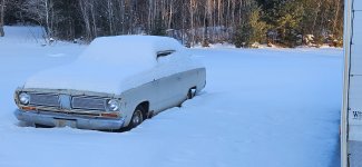

I have this car as well. I am not 100% sure what plans I have for it at this time. I do plan on swapping out the 3 speed for the OD Pierre already rebuilt for it. It's in the trunk along with the bellhousing, new clutch assembly, and shifter with linkage. I have all the parts for the big bolt swap too. He had planned building a 8.25 for it. I have that and the gears but I also have a extra a-body 8.75 here. I might do that because as it turns out I now have a bakers dozen 340s along with parts to build them.

I recommend moving the clutch, pressure plate, flywheel, anything like that, inside before it rusts or is otherwise damaged by the wet and damp.
That will be a cool car with the drivetrain upgraded like you're describing.
I'm sure it will be fine. It's no different than the car sitting really. Although that is a good idea and I think I will do that tomorrow.

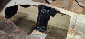

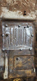

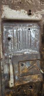

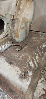

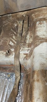

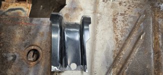

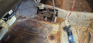

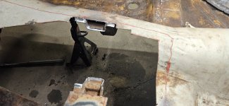

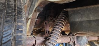

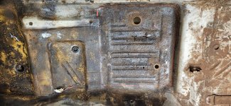

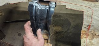

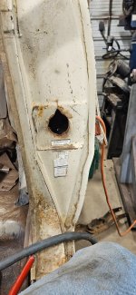

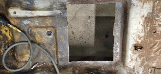

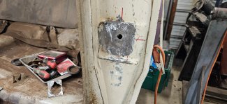

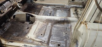

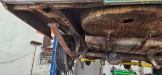

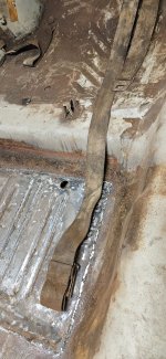

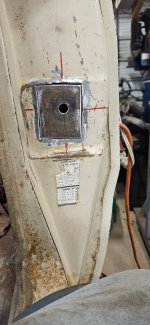

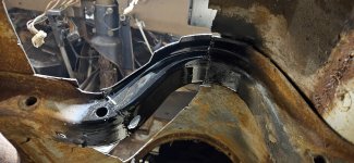

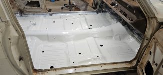

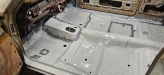

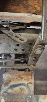

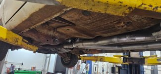

I did get this car running and driving over the summer. It needs some chassis work. It also needed some torsion bar cross member work. Whoever swapped the 3 speed bolt action shifter from the column to the floor butchered the cross member. I hand to section in a piece. Fortunately Keven had purchased a torsion bar cross member for The pink dart. He sectioned in his repairs and that left the part I need unused. I preformed some floor pan repairs using pieces cut from the '74 Duster I sold the frame rails out of.

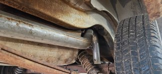

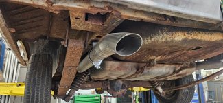

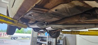

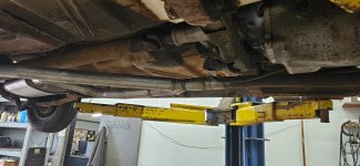

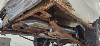

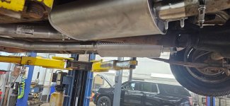

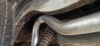

I also bent up a custom dual exhaust system that I can easily tie into once I change out the K-frame and drop in an LA. Not sure if I'll use my 318 out of Pierre's Imperial, my 1965 273, or build a 340 for it.

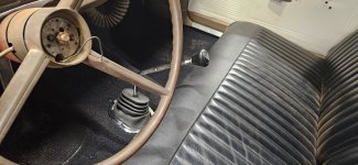

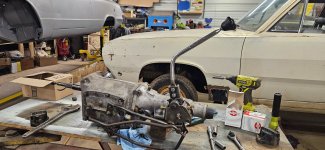

I also installed the OD 4 speed Pierre had built for it.
As it turns out the 71 challenger had shockingly similar butchery. I'll elaborate on that in a thread I plan to start soon.20250624_183246.jpg20250624_184711.jpg20250624_193657.jpg20250628_175342.jpg20250615_174109.jpg20250615_175842.jpg20250705_191750.jpg20250705_191755.jpg20250705_191803.jpg20250708_195932.jpg20250708_195914.jpg

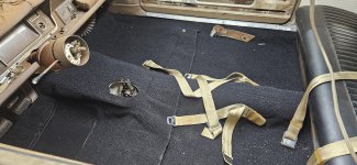

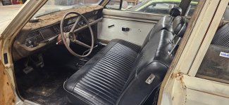

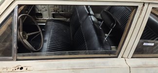

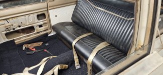

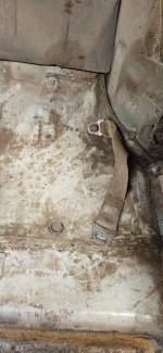

I also installed new carpet and the seats. The seats are out of a Dart so I need to modify the rear seat frames. The valiant has a shorter wheel base so the wheel tubs interfere with the seat frames.

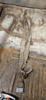

The original seat belts were filthy and moldy. I cleaned them in my ultrasonic cleaner and scrubbed them with color safe bleach.
