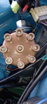

So I redid the spin to compression on #1, pulled up the pump shaft, had to do it a couple of times it spins quite a bit on the way in, but got it to the front drivers manifold bolt.
So I pointed the vacuum thingie to the pass. side & dropped the distributor in, rotor also pointing to the bolt.
Hmmmm, looks like the contact to the cap in on the other end, Am I 180 off
Had to go back to the book, it had 2 # 1's on it, small block said clockwise, that is also to #1
now I have to figure out the plug wires, I'll follow the book & hope I don't screw that up!
