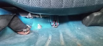

Not much accomplished, took the back seat out, went n to see what screws I needed to fasten the bottom of the back & already hit a problem, the piece to screw to on one side is gone! 20240416_131753.jpg20240416_131745.jpgSo I dug out 1 screw & a couple of washers & got the good side done, the other side I tied in with wire, hopefully no one will be sitting there in a major crash!
I thought I might bend the hook on the seat, but that would not be easy, so she sticks up a little extra on that side (as in the pics earlier) 20240416_132735.jpgPulled out the drivers seat & crawled in, connectors looked good, did a test on the ignition switch & with key on I get a beep from red to black (black feeds right side of the fuse box)

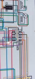

In the diagram I bought there's a dot between the top sockets & the rest, does that not mean they are NOT connected? 20240416_155227.jpg20240416_155413.jpg
tried to follow the diagram to see where the heck it gets power from but those wires run all around in friggen circles!

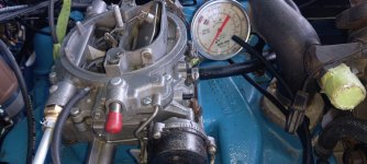

Having had enough of that for one day I started the motor & let it get hot, timing holding around that 10 mark, vac also still around 10, lowered the idle a bit more messed with those screws no success on increasing vacuum.
replaced a funky looking hose on the choke side, no help there , is that choke adjustable, this is about how far it opened, car running quite a while & hot! 20240416_152128.jpgSo that carb fitting was still moist on the bottom, last ditch effort I pulled it, wrapped the metal gasket in teflon & the threads & put it back in, so far it seems to be holding but I only ran it a few minuets.20240416_154607.jpg

I did again snug down the carb bolts again, there are pretty darn tight, I'm afraid to break something!
I think I will then try a bead of silicone on the front & rear manifold areas & see if anything changes, that DID work on the other car!

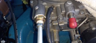

So that carb fitting was still moist on the bottom, last ditch effort I pulled it, wrapped the metal gasket in teflon & the threads & put it back in, so far it seems to be holding but I only ran it a few minuets.View attachment 27587
Use teflon tape very cautiously. Gas will break it down and flow into the carb causing a real nightmare. NEVER have it anywhere near the open end.
I do believe all the fuses have to be connected to the power bus, which is what I'd interpret that rectangle to be. It is curious that one is connected a red wire and the other to a black wire though.

I was looking at that diagram of the fuse box upside down, if you look close the buss stops at 3.

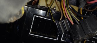

So I saw the light one was actually fed from the dimmer switch , so apart came the dash.
if I jump power to center post I get power to that fuse, yea, I also discovered it only gets power when the light are on. Still nothing lit up. 20240417_133707.jpg

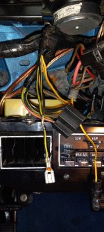

So while I was messing with the connector one of the wires broke, weather it was well connected before that is unknown. (one of the black/yellow T) 20240417_133938.jpgfixed that pretty easy but went to put the spade back in & it won't lock in that little spade in the back broke off, now I have to rube a way to lock it in!!! 20240417_151052.jpg
So I hit the spare dash parts, I bought a switch panel when doing the other car, well guess what's missing, yep the dimmer switch! 20240417_160336.jpg

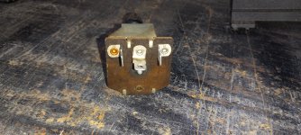

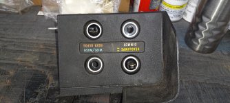

20240417_160351.jpgbut I cannot get continuity from either post to the outside post. I got the copper contact under the point clean & can read continuity on the copper further up, but nothing on the other side, there's a copper thing that gets pushed down to hit the inside point for that lug, have continuity betweeen the post& the copper spring thing?
Can't figure how the power goes from one side to the other if it's supposed to? 20240417_160413.jpg

Now when I power up the 3rd prong hole in the connector for the dimmer it triggers a circuit breaker in the probe (same one that got my jumper wire hot the other day) I think that means I have a short somewhere in that circuit, which is the one when the switch on the dimmer is on, which feeds the dome light to, but the dome light works on the door switch, this is making me nuts.
So the 2 accessory plugs I found, one red, one by the steering column yellow. I found 2 more way up in the top of the dash, one has some radio wires connected to it & the other I can't see it's above one of the hold down brackets.

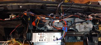

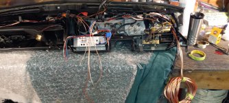

Gonna search my old pics & see what the wiring looks like while I was building it?
Went through the dash rebuild pics, not helping much, & there's no sign of a 4 way flasher unit or even a plug for it that I can find?
Best pics of the wiring mess, I'm pretty sure the radio is not the problem as far as the main wires go, it's one of the few things that work. the light wire for the radio I guess could be? 20230813_155438.jpg20230815_153804.jpg
