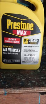

So I'm looking around at green anti freeze & they come up with for asian cars, is this the same stuff I need.
my auto zone has peak & prestone max, any preferance?
The antifreeze you need isn't specified necessarily for any cars, other than "literally every car in the world older than 1990". Look for "conventional green" and/or "ethylene glycol" on the label. Antifreeze is antifreeze, it all comes out of the same plant so get whatever's least expensive. Either buy premix 50/50, or use distilled water with full strength.

So after driving the counter guy nuts I got the tranny fluid, no problem there & the antifreeze,
I had brought up 3 of the ones that came up when I searched green antifreeze, with the big list of asian vehicles on them. told him all yellow came up when I did the car on the computer, he did it on his, we brought up 3 of those, I open one & in the YELLOW bottle it looked yellow, he said it's green when you pour it out, get a water bottle & sure enough it was green, so I bought it!

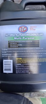

anyway, 1 1/2 gal in the tranny & it's over in the tube, hoping it will go down upon startup.
put 3 gals in the radiator & still short.
20240318_140046.jpg1st line under the box says it's good for dexron 2 & 3 20240318_140655.jpg

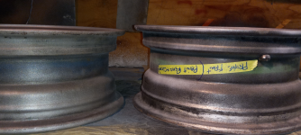

here's that pic of them on the bench, looks like about a 1/2"

That's not green antifreeze, it's yellow. It does look greenish to an extent coming out of the jug, but it's not the vivid green of trustly old ethylene glycol. That's why I gave the information to find on the label. I highly doubt you'll have an issue, but old-fashioned green EG does have better heat-transfer characteristics than what you bought. The transmission fluid you bought is obviously Dex/Merc; why they didn't specify that on the jug is beyond me. Again, I would've used Type F/FA but what you've got is fine.

Jass, if you say no 7s what the heck is this (below on the bench) it measures 7 from bench to top & pretty sure when I had the others next to it, it was 6 1/2.
So mine are 6's on the car now?
then the rings should fit, they said for 6 & 7" rims
Me going nuts!
so I pull out the 7" rim, measure the lip over the tire bead & it's about 1/2"

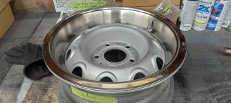

Pull out a trim ring & it went on with just my hands banging it down, PERFECT & it was in tight! 20240319_132302.jpgonly 2 tiny marks on that inner ring where it was bottoming out on the other rims? 20240319_133136.jpg
So the only real problem is the extra 1/2" in depth & the way that inner extra lip is shaped.
So if you measure the width from inside that lip I guess I'd lose the extra inch & end up with 4 -5 1/2s & 1 -6
Obviously you've now figured it out. A 14x6 wheel measures much closer to 15x7 on its outermost dimensions. And, as we've covered a couple times now, there were no 7" wide 14" Rallyes. If you wanted that wide a wheel you had to step up to a 15".
From 1970-'74, all 14" Rallye wheels and "Magnums" used the same trim ring: 2944424. It was used on both 5.5" and 6" wheels, with the 6"-wide Rallye wheel being introduced in 1973 as an up-option over the 5.5", which remained the "base" Rallye wheel through, I believe, 1976.
Looking at pictures in both the parts catalog, in your own post, and of a set of originals for sale on eBay (for an eye-popping $650--used!), it's blatantly obvious that your aftermarket trim rings are not reproductions. That lip at the inside edge does not exist on original trim rings, and that's what's causing you most of the grief. The retainers might be part of the problem but with that lip they're never gonna seat. They're simply too deep, plus they flare outward at the innermost diameter which will not clear the wheel's rim. The inside edge of the trim ring is not supposed to contact the wheel center. There should be a gap there, which you'll see if you reinstall one of your originals.
