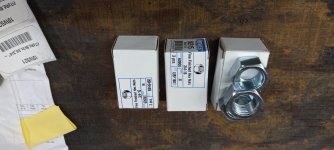

It was in stock, though--that's part of my point. I put "Mopar balancer installer" into an internet search and the Summit listing for the Performance Tool set was the first or second link. Typing the same into Summit's own search bar brought up the Proform kit.The guy I got at summit was pretty good, he said the tool was not in stock & gave me the bolt size, which I of course screwed up at first. when the new bolt got here I checked the threads & measured it, it's a 3/4 bolt with 16 thread teeth.
He also mentioned heating it up at 200 for 30 mins. before install & a little grease on the snout.
monday I'll order the cover, gaskets & a new seal & muddle along from there.
