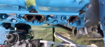

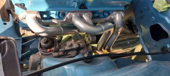

Wow, I'm too old for these marathons! Did get a lot accomplished, drivers side header is in, but it was a battle. would not drop in from the top & from the bottom they would not clear the starter, Doc, you were right putting the starter in after was A JOB, I put the wires on it & then wormed it in there & fought with the nut & bolt!
then on the headers I had snugged down 2 & went to put the rest in & the 2 tight ones under the angle of the pipe would not even go in the hole, backed off the snuggers & finally got them started.
So when I temped in the other side the bolts did not go in easy, so before I did this side I ran a tap through all the holes.
I did not have to do anything with the steering links, caught a little break.

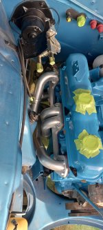

There be a header!

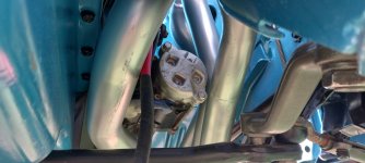

Mann I'm so glad I had a mini starter, not even sure a big one would fit it there.
It's surrounded by pipes, that heat can't be good for it?

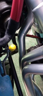

Gotta route the wires next & find a way to get some clearance!

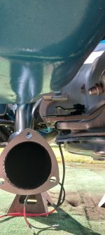

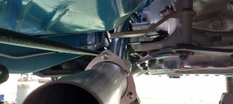

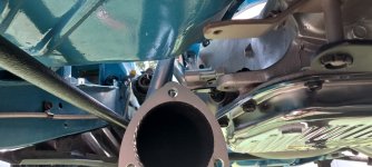

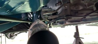

On the bottom so far it looks like the linkage will clear, next time out I'll put on the flange & see what room is left.
It's pretty far behind & above that flange, not sure how big & fat the other end is yet?
There be a header!

Gotta route the wires next & find a way to get some clearance!On the bottom so far it looks like the linkage will clear, next time out I'll put on the flange & see what room is left.
