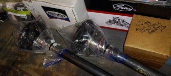

OK I think I'll order that & the distributor with the tan cap, not that the color matters, but what the heck!

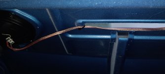

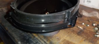

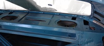

I'm not sure what you mean about gaping holes. Are you talking about the cutouts in that thick blue home-made disaster? If you have a new package tray ordered, what does it matter? As long as you ordered one for rear speakers you'll be fine. The tray has slits in it for the sound to come through. It'll look stock too, instead of those ghastly grilles the speaker companies provide.Also noticed, damn, there's a gaping hole over the speaker, I will need to buy or fab some kind of cover, & after not using the one speaker I had that had 2 covers in the box I threw them away!!!!!!
No, there are slots that look like grilles as part of the tray itself. No cutting required, no dotted lines.I have them ordered at year one, but if they have slots I'm good to go, the way I read it was cutouts for the rear speakers, I assumed the ole dotted lines to cut around?

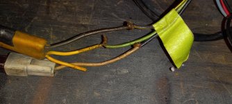

Both the RB and LA distributors that I'm using in the Duster had been hacked like that, so they both got new pickups. They needed it anyway.Proper plug too, now did they cut mine off to hook up the other distributor!

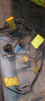

I looked at the other side & there's an extra wire there too?
Looks like he had a kill switch, that was all chopped up, but there's a bunch of other wires just cut & hanging?
the others go into homemade connectors
I have a parts harness for Mr340, all the wires go to the secondary on his!
