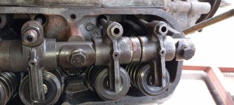

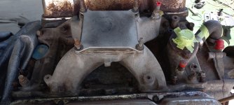

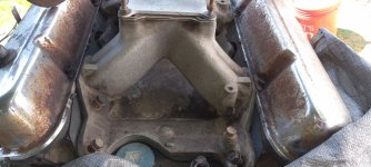

As far as the valvetrain situation, let sleeping dogs lie below the level of the heads. Leave the cam and lifters alone, assuming you know each lifter is on its correct lobe. If you don't want the adjustable rockers, replace them with the ones
@mr340 gave you (after a good cleaning) and new stock-length pushrods for non-adjustable rockers and a hydraulic cam, preferably something a little beefier than stock. Just look 'em up for a '72 340 at your speed vendor of choice. You don't even have to remove the intake to do it, just be certain you get each pushrod centered in its lifter. I do it by feel, but you can see down there with a penlight if you need visual confirmation. DO NOT DROP A PUSHROD.
They can travel all the way to the oil pan given the right circumstance.
