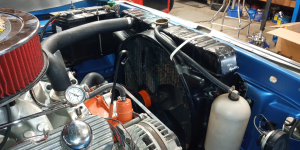

The OER part was $200, came out of the box cracked and looking like someone had already had a hotglue gun trying to fix it. I figure they would all be junk and cracked that way so I patched in a bit of sheetmetal and JB Weld to fix that. Then I let it sit on top of a pile of parts while I had the engine out and when I put it on it was warped like a banana. The big white zip tie is holding it back against the radiator.
Looks like one of my A/C duct ties!
I used to buy by the case, I have 5or 6 left for emergencies!
Running out of duct tape too, another case load item, it hurts paying like 10 a roll at the hardware store for crappy tape.
That's actually two zip ties hooked together. Each is only about 2 foot long.

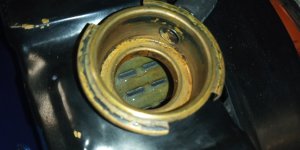

I started with this
The parts store rad had 3 rows of these itty-bitty tubes with the core narrower than the tanks
The Cold Case has 2 rows of these with the core as wide as the tanks.
In process

Also, note the big gap where the shroud should meet the radiator. It's designed that way and I'm not sure trying to fill that gap would improve it.
