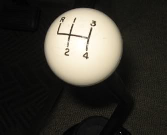

We got the trans, bellhousing, and shifter, along with an LD340 intake and a 600cfm Holley carb at a swap meet for $100. Found a used 340 flywheel and had it machined locally for the externally balanced 360. I found a used floor hump for $50 online. We got the rebuild kit for the trans from Brewers. Found various parts at junkyards (shifter rods, extra shifter) and swapmeets (Z-bar and Z-bar rebuild kit). Got a new heavy duty Ram clutch and pressure plate, which was the biggest purchase (around $400). Got a set of A-body shifter pedals online for $50, they just needed to be cleaned up and painted. A great guy on Abodiesonly.com sent me an old school white shifter ball for free.

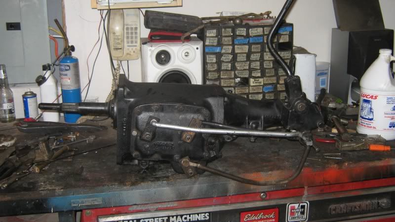

Our $100 score, dig that baseball shifter knob.

Believe it or not, the workbench is super clean compared to what it usually is. :shifty:

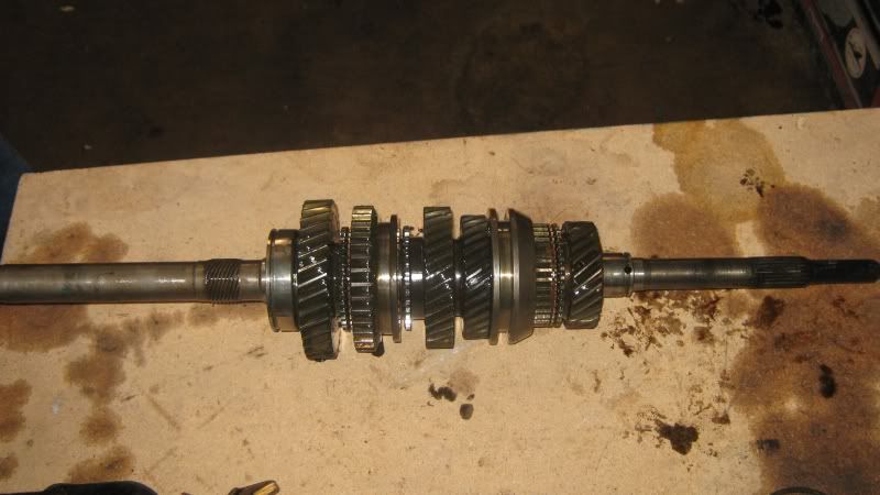

Rebuilding the trans
Piggy can now do 727, 904, and A833 transmission rebuilds.

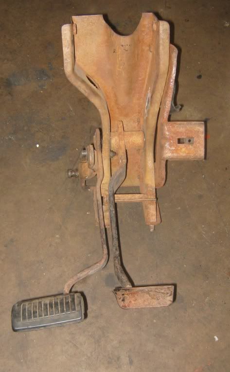

Before shot of the pedals, I forgot to take an after shot.

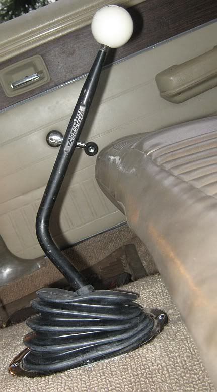

I think there is chrome under that ugly black paint on the shifter. One day I'll look.

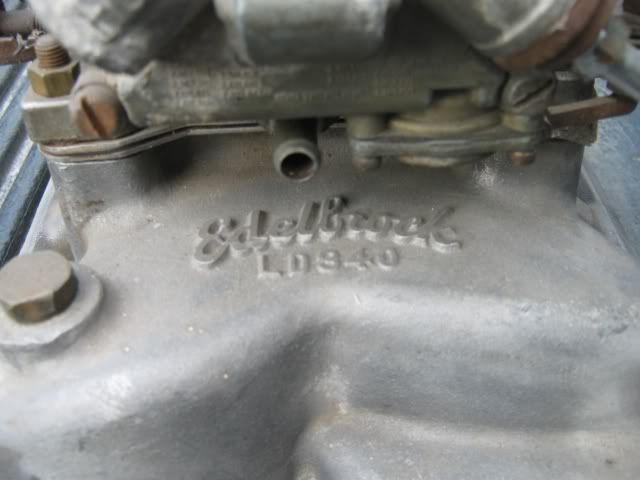

LD340 and Holley carb that was included in the deal.
